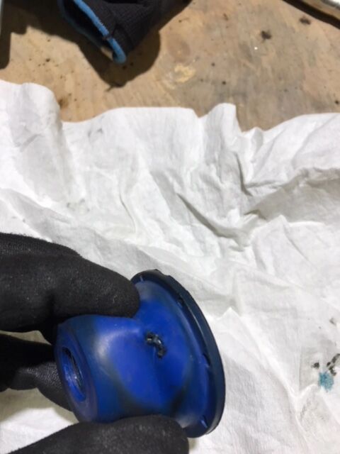

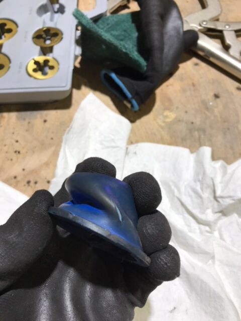

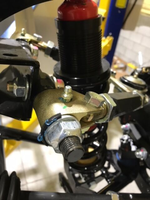

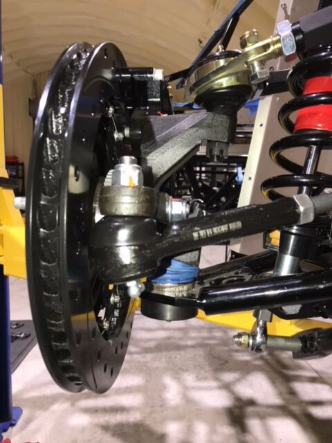

    UCA and Tie Rod Dust boots
    I had purchased the Energy Suspension tie rod and UCA Dust boots on Amazon, part numbers 9.13101G and 5.13102G. They were only like $14 and I wasn't sure I would put them on. It seemed like a lot of extra work but I figure its easier now than later. I was glad I got them because when I went to inspect the FFR boots I noticed the left UCA boot was cracked in one spot and actually had a hole in another.
    Here is the crack
    and the hole/tear
    Here are the new boots from Energy Suspension. sorry about the quality of these photos.
    The LCA boots looked good. I'm not sure why this happened but I'm guessing its because the front suspension had been "hanging" for a couple of months because I was waiting on my coil springs? It looked like maybe they got pinched against the spindle assembly in that position.
    Just before I wrapped up for the evening I over tightened the locknut on the pivot shaft of my left UCA. The gasket ruptured. I can't believe I dd that Really?! did I really do that??? UGHHH!!!!

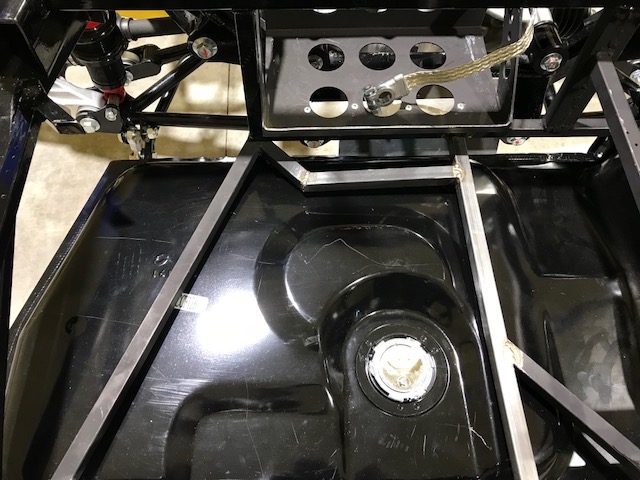

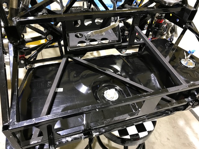

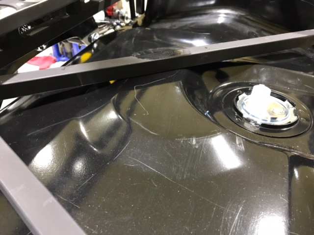

    More Trunk Mod set backs but I'm getting there
    I mocked up the fuel tank and went to install it.
    Hard to see in the photo but one of cross bars is blocking the tank from coming all the way up.
    I realized when I first measured I hadn't bent down the sides of the tank Hmm. No worries, here is where I am with the fix.
    I'm learning to be more proactive about reading ahead in the manual. And, I know, I need to make sure there will be no issues with the rear wiring harness...
    I'm planning to PM robertjamesellis of this issue before he tries this mod.

    No PM needed. I've been keeping up with your thread. Thanks for the heads up on this. My tank is on order from Breeze and when It gets hear I'm going to tackle the trunk modification. I'll take note of this. Thanks for making the sacrifice for me and finding those hiccups before I do!

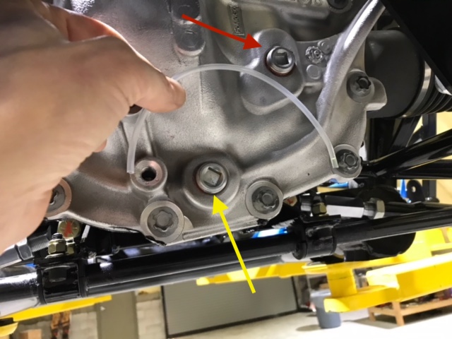

    Differential Fluid
    Theoretically the differential fluid status of the IRS from FFR should be pretty simple, however, Jazzman and Edwardb both drained theirs and had to refill with new fluid. It hasn't been completely clear to me where the drain hole and fill holes are. I took an educated guess and opened what I think is the "fill" hole and used a pipet (just like in High school chemistry) to check for fluid. Sure enough, clear yellow clean rear diff fluid!
    The red arrow is the fill hole where I put the pipet and I assume the yellow arrow is the drain hole.
    I think I just saved myself $50 in differential fluid. Ask me how I know!

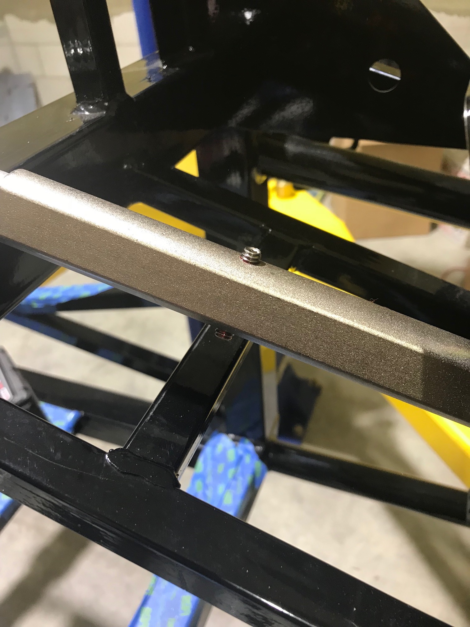

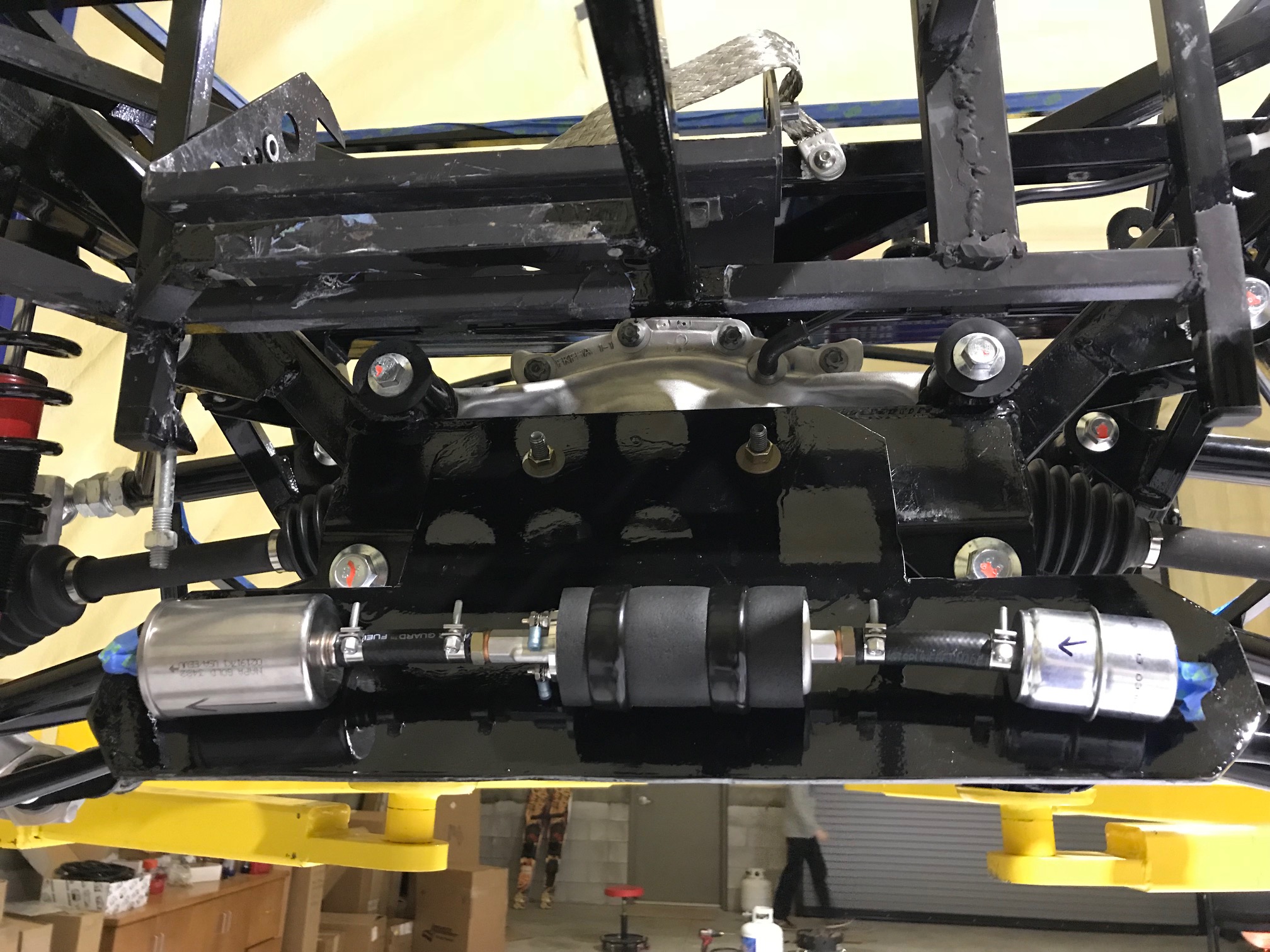

    I took out my steering shaft and installed two set screws to keep it from wobbling. They are 1/4"-20.

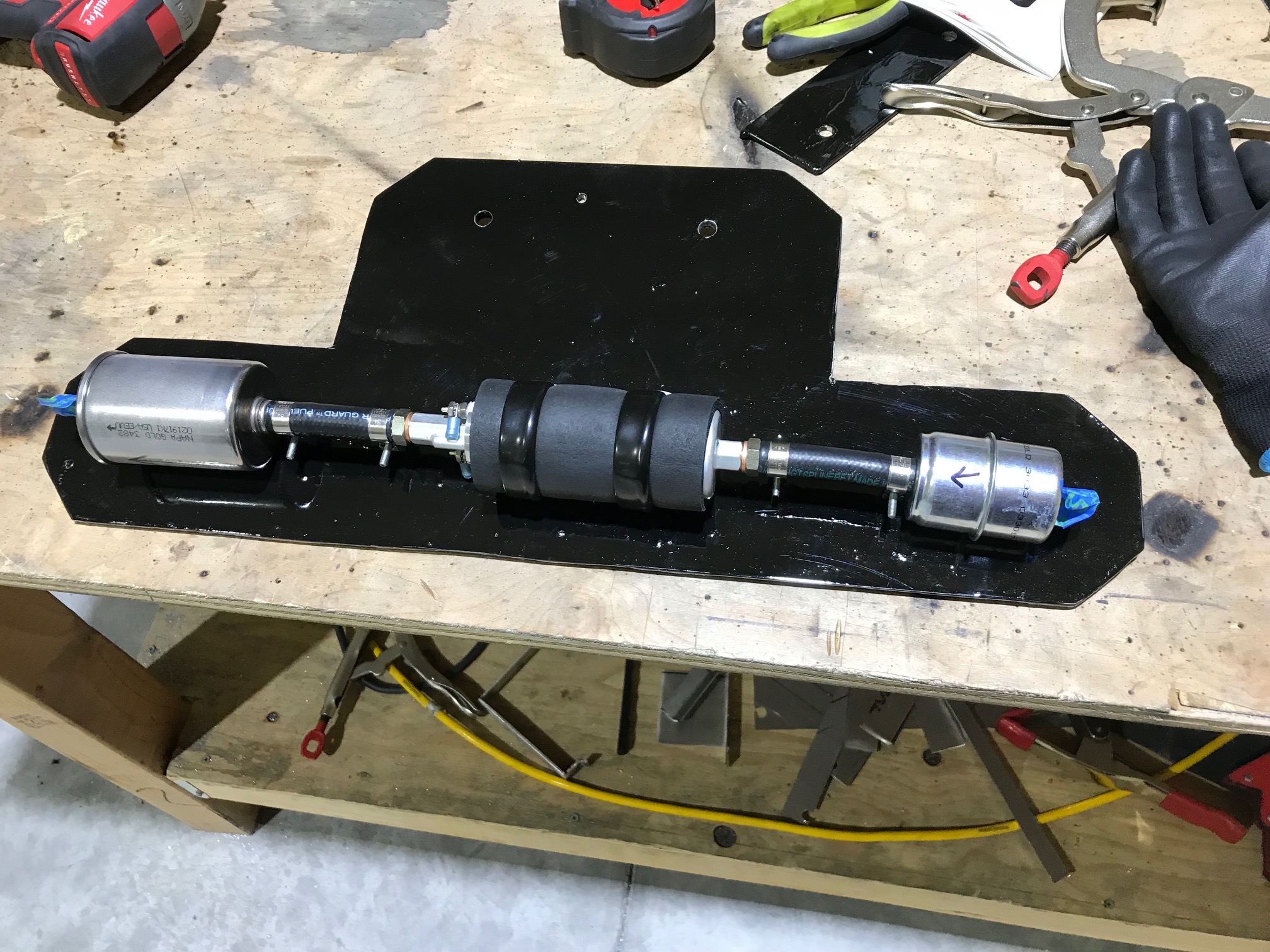

    I have a Holley Sniper EFI with my DART 347 and it came with an "inline" fuel pump. I made a bracket to mount it on.
    I mounted it just behind the differential. Holley website says to get it as low as the lowest part of the fuel tank and as close to the tank as possible. Couldn't find a lot of threads demonstrating this, it seems that most people use the "in tank" pumps. I figure I'll go with it, at least until I run over a skunk or raccoon and it gets yanked off...

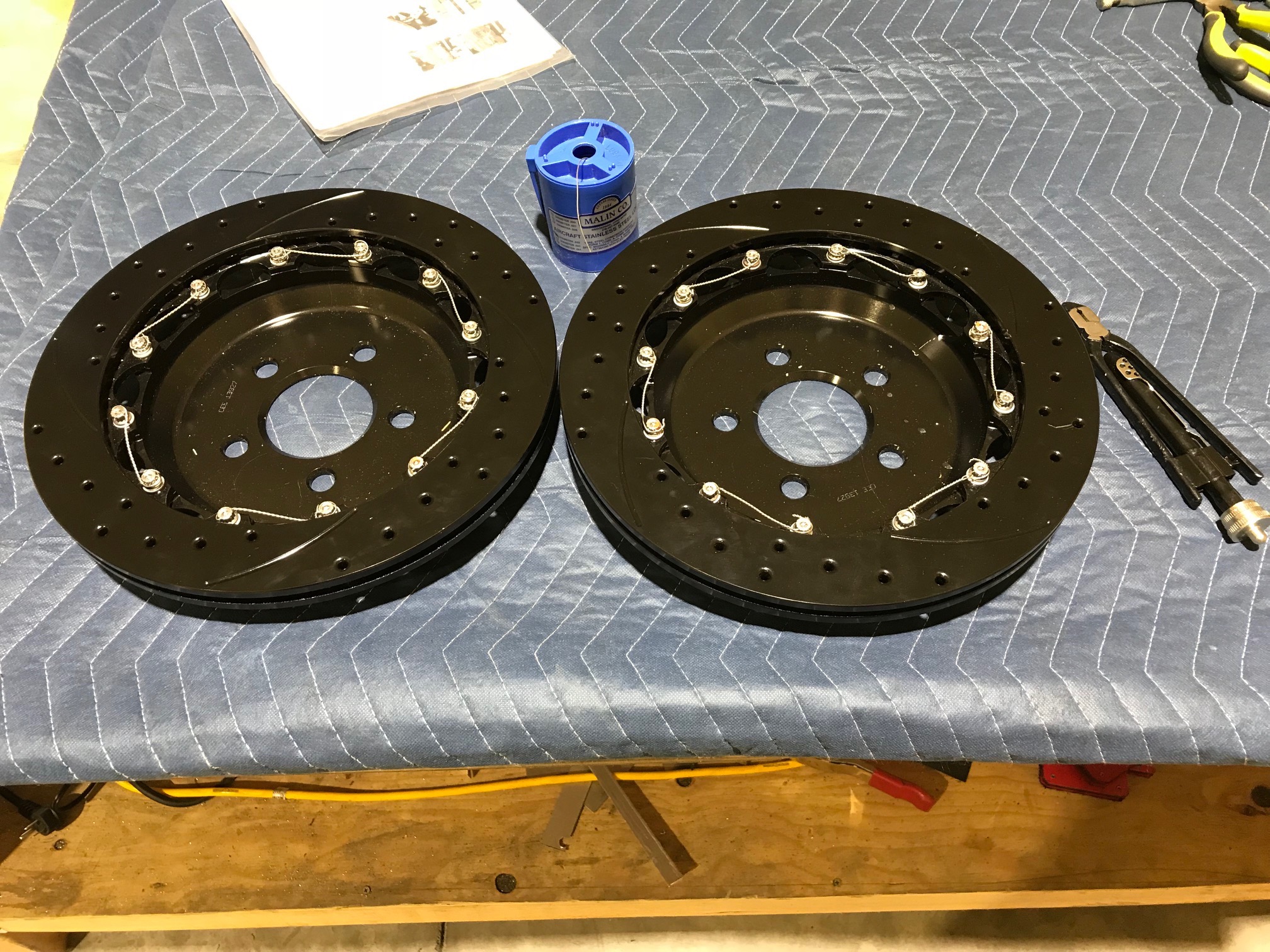

    Finally, started working on my rear Wilwood brake install. Got the hats and rotors put together using red locktite and my inch/lb torque wrench! Used my $10 Harbor freight safety wire twisting pliers ( which work great! ) to apply the twisting wire.
    Incidentally, for any new builders like myself, Wilwood brakes are great but be careful because they paint (powder coat?) right over the bolt or nut threads. This makes it difficult the first time you install them to thread the bolts/nuts, its easy to cross thread them which can be a very expensive mistake (Ask me how I know !). I read one forum member who was a helicopter mechanic recommending you should always tap or die important threads. Tap and die sets range from like $30 on Amazon to hundreds of dollars. I started with the Amazon $30 set, after I broke two taps I went to Harbor Freight and got their upgraded $85 Titanium sets, both metric and SAE, and have been very happy with them. I also use Tap Magic cutting fluid.

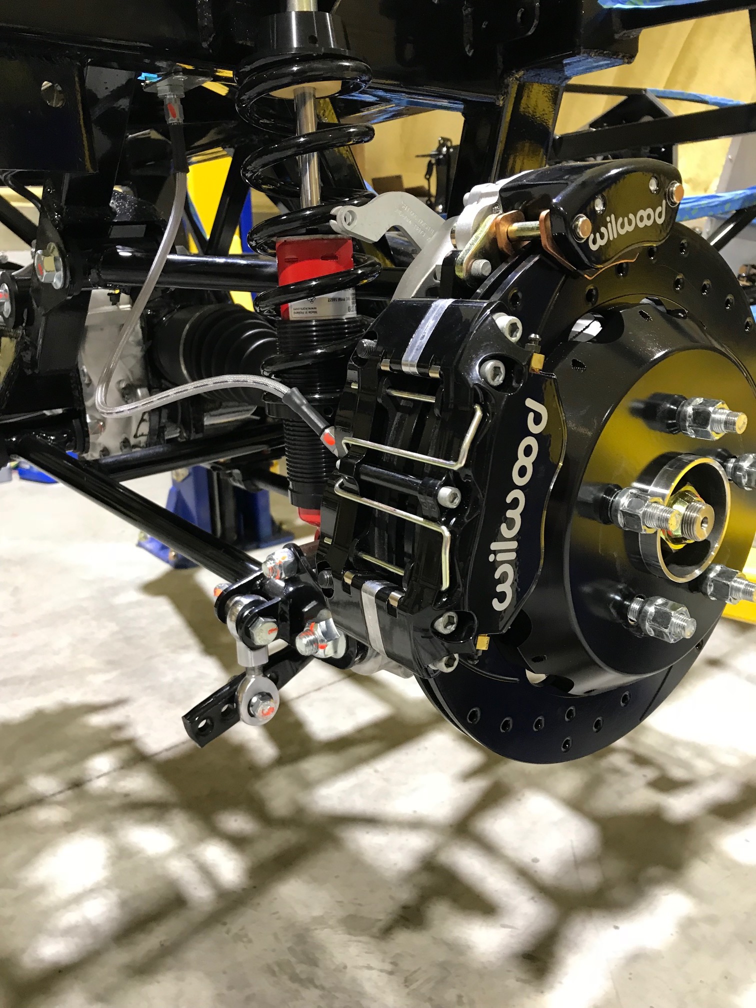

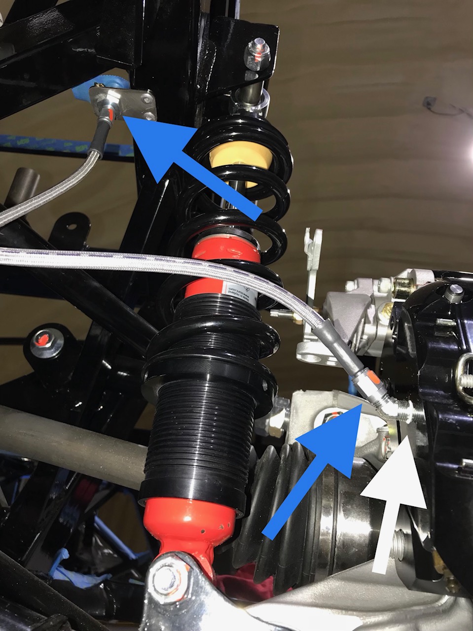

    Rear Wilwood Brake Install cont.
    I got the rear Wilwood brakes installed. It went smoothly.
    I do have a question . I used thread sealer where the White arrow is and did not on the Blue arrows. Should I?
    I struggled with the E brake all weekend. Had multiple little frustrating issues. I'm hoping to finish it this weekend before the Super Bowl. The good news is that it will be a solid functioning weather proof install.

  13. #132
    11,135
    Quote Originally Posted by Mark Eaton View Post
    I do have a question. I used thread sealer where the White arrow is and did not on the Blue arrows. Should I?
    Correct. Yes sealant on the 1/8-27 NPT fitting where it goes into the caliper. The taper on NPT threads along with a sealant material allows them to form a seal. I use Permatex or Loctite sealant from a local parts store.
    No sealant on the -3AN fittings on the flex hose. AN fittings seal via a metal-to-metal tapered seat. You didn't ask, but seems many do. Also no sealant on the double flared brake lines once you start doing those. They also seal via a metal-to-metal tapered seat. When doing those, a little lubricant on the double flare and tube nut threads is a good idea. You need to crank those down pretty good, and lube helps them seat properly. I use a touch of brake fluid.

    I also re-routed my rear brake flex lines so they would be easier to access when the build is complete.
    Next up I will put on the body for a fitting. Looking for any advice on that, I know Martin recently put his on. I will read his thread for the advice.
    I also re-routed my rear brake flex lines so they would be easier to access when the build is complete...
    I'm not sure it's good practice to route the brake flex line through the suspension like that. Close to the UCA, CV axle and coilover. In an earlier picture you had the flex line attachment behind the suspension. That keeps it clear of everything and is the better choice IMO. Maybe some others have feedback. I wouldn't normally say anything regarding personal preferences. But this seems like a safety issue to me.
  30. #148
    Mark Eaton's Avatar
    Medford, Oregon
    765
    Thanks for the input Paul, I thought about that but it looks like it clears them pretty well. I'll try to take some more photos this week to illustrate. Further, unless I'm mistaken that is the second option listed for flexible flexible brake line mounts with IRS on the October 2017 version build manual, page 205. They ran it over the UCA, I ran it under because it looked like there was more room.
    My son Tom showing one possible location of the ABS module
    That is the location I used for my ABS controller Unit. I had to make a bracket from angle iron to bolt the factory bracket to.

    Rear Brake flex line
    Here is a photo of location option #2 for rear brake flex line from the digital manual, Oct 2017 version.
    I believe this is the same view of the way I did it.
    It looks like I place it about two inches lower and on the fore side of the square tube than in the manual. That wasn't my intent. The question is should I move it to the same position as in the manual?? The routing looked better below the UCA which does bring it closer to the CV axle. I think it clears the coil over pretty well. Any opinions?
